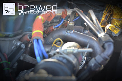

                            some testing on my s13
                              Here is the secondary air injection Rally style Anti Lag set up i built for the KA-t while back in the states this winter. Car runs a V1 AEM, I'll also be sure to post up some video shortly.
