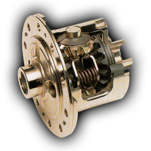

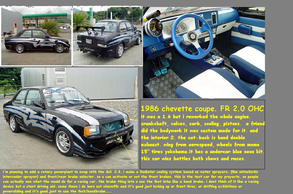

    does anyone knows if there is a LSD or posi traction system to improve the power delivery of my drift Chevrolet chevette. i suposse there is something aviable, probably in the united states. any chevette owners can help me or tell me anything that can be usefull. i'll take anything from a universal adaptable thing to a full wide modification. i just need the ideas... thaxs a lot. this is my ride.. from caracas venezuela.. eats Vtec for dinner every night
