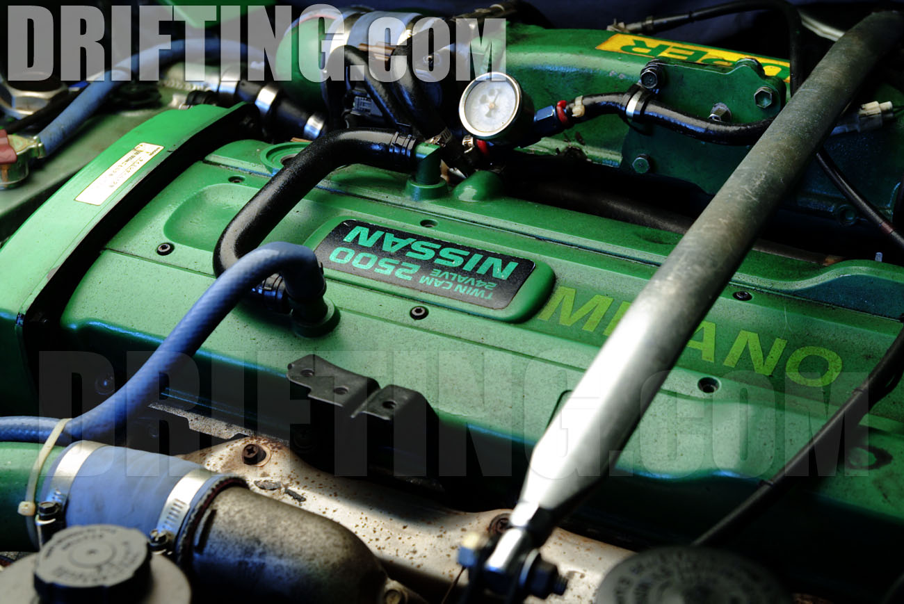

        Contact Chris from Milano Auto.
        He is installing another one in his new car.

              I'm sorry but No, this is blatantly wrong.
              Mark from Slide Squad has a RB25DET swap in his S13 and he has absolutely no problem drifting his car what so ever. In fact, he has mentioned to a few people that it is almost easier to rotate the car around the nose with the RB25. As for the weight issue, it's not nearly the big deal that people make it out to be. The RB25 with the McKinney mount kit weighs ~160lbs more than the stock KA24. Since the McKinney kit moves the engine 2 inches back and 1 inch down from where the stock RB25 mounts would put the engine, this really isn't that big a of a deal as the engine is more centered over the front contact patch.
