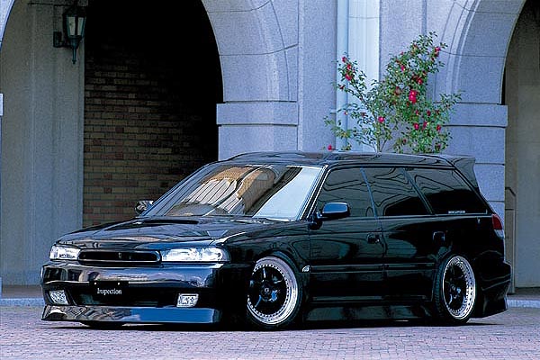

    If I need to get another car I'm thinking BG Legacy (93+) simply because they're hot, they're AWD, they come in a wagon, they're affordable, and they're reliable, but all that is besides the point. If you don't understand why a BG Wagon, you will when you're older (or just look at my "I love wagons" post in multimedia) .

      By "Understand when you're older" I mean like this:
      I'm only 21
