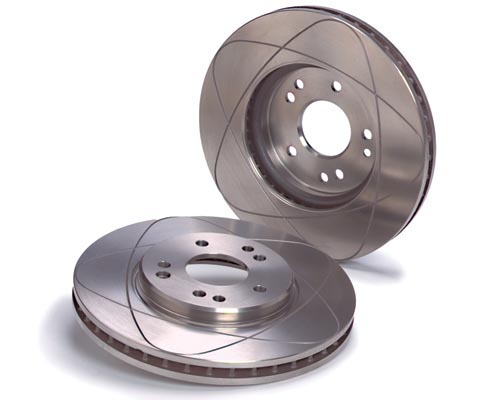

                [QUOTE=GRiDRaceTech]Slotted brake discs are blank brake discs into which grooves have been cut. The grooves may extend in an arc to the outer edge of the rotor, or in straight lines.[QUOTE]
                Like this right?
