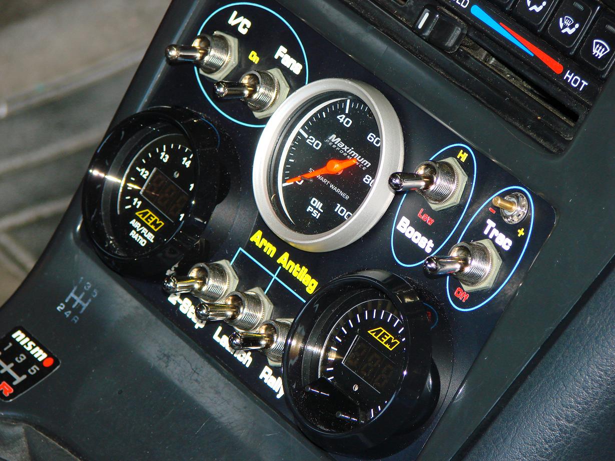

Custom designed and fabricated gauge panel with-
AEM UEGO AFR gauge with sensor controller
AEM 19-channel serial datastream multifunction gauge
Mechanical oil pressure gauge
Switches for-
FAL-210 dual electrical cooling fans
Spearco liquid/air intercooler pump
wastegate power on/off
switches labeled for anti-lag and traction control functions and wired into EMS, but not activated

Gauge and switch panel

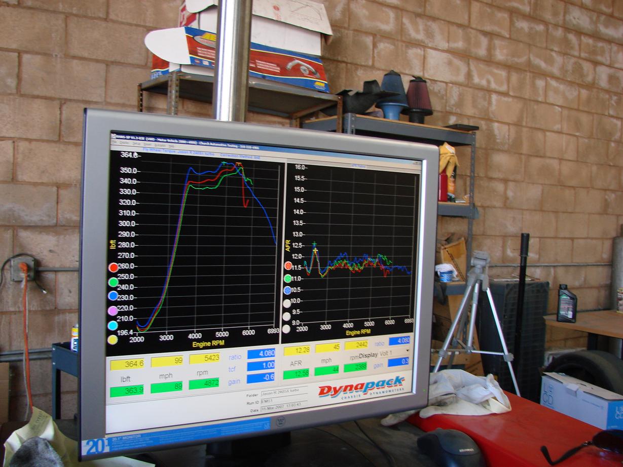

Dyno taken at only 14psi. Car is running at 19psi now, values are about 35 higher across the board while on-boost. Approx 500 crank hp.
