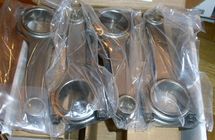

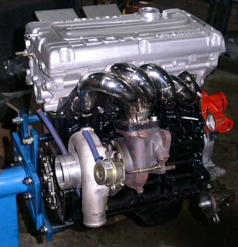

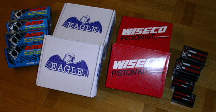

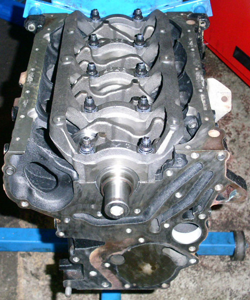

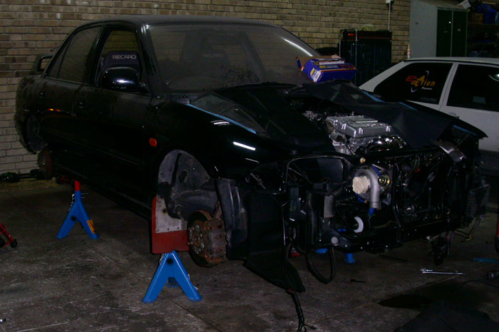

        A few pics :-)

                Today i took the help of a close friend to remove all the asphaltmats on the floorpans & in the trunk - a total of abou 25kgs.
                Also we remowd the ABS-thingy... & the rear wipermotor & wiper + the electric antenna. - Also a lot od brake-piping since i´m gonna usa an hydraulic handbrake, i will not be able to, anyway, use the ABS & i weighted a fair deal too.
