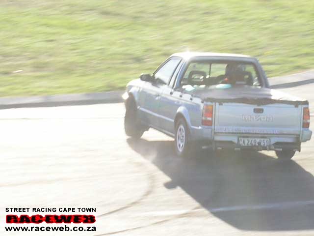

                            this is the most insane truck drift i have seen,
                            done on manfield park raceway during a truck race, he linked the castrol esses and held it onto the intermediate straight.
                              heres another shot
