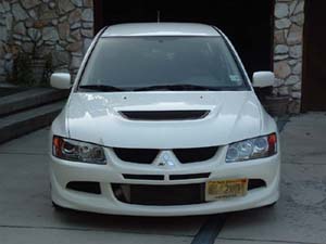

    just starting to get into drifting, not the best car for that purpose... but anyone with similar car can give me some advice. got a evo viii. i know heel toe and left foot braking well...how do i use that in drifting. pretty much able to do really well in grip. let me know ppl!!
