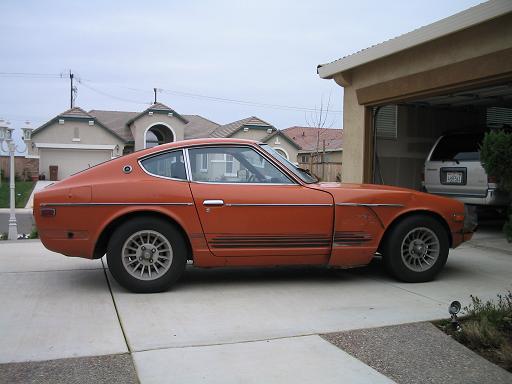

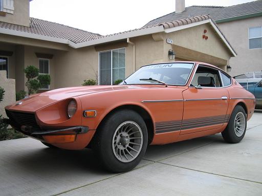

Hey Ghost, did you have any problems with fitment or getting the 302 in the 240Z? I've been thinking of going this route when I get a 240Z.
My 240Z
Well, my mind isn't made up yet, but it's pretty tempting. For one, I drive a rotary, so I kinda have the desire for a car that has lots of torque. Second, whatever motor I build it's probably going to be in the 400-500 hp range. It'll be a lot easier to get that power out of a v8 than anything else. Third, it'll probably be cheaper to build a v8 than a stout turbo motor. Besides, I just love the sound of a well built V8. Anyways though, I don't even have the car yet so I'm getting way ahead of myself.
