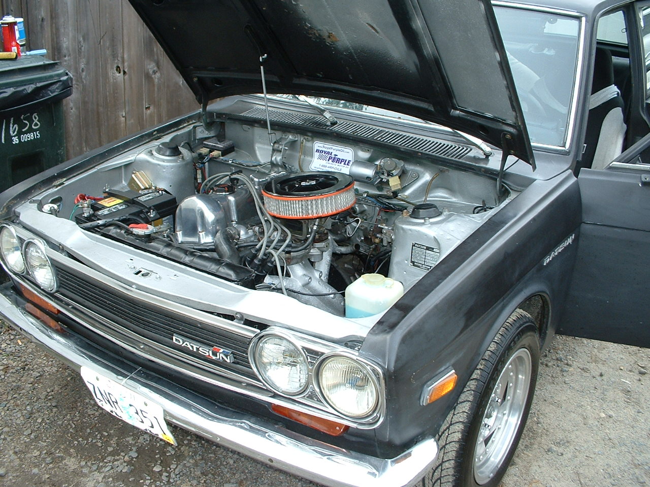

                I just blew my L20B sunday evening on the way back from Portland to Grants Pass. Trip ended at 4 in the morning instead of midnight, - lovely 4 hour delay. Blew the #1 rings, 0psi. #2 30psi, #3 65psi, #4 60psi.
                Oh yeah, rings were shot. Smoked like hell. Burned 5 quarts of oil on the way back, too! Awesome!
                Okay, so I sent the engine in today, and should have it back by next monday or this Friday. Its getting a .040" overbore, using ZX flattop pistons (should yeild around 11:1 compression, a big high for the street but worth it for the power. Also going with a hot camshaft, new rocker arms and lash pads. Valve grind is <4k miles old, so the top end is good. New timing chain set, including upper, lower gears, chain, and tensioner/guides. New rod bearings, main bearings, as well as piston rings obviously. I am shooting for total-seals but I can't seem to locate any (know a good source??). Also bought a new Roadster competition clutch, which should have enough bite to break a driveshaft before it'll slip. That will definetely be nice! On top of that, I am having the entire rotating assembly balanced so she will rev a bit higher and not be so vibration...y. :-)
                I should be yeilding around 140hp with the high compression and hot cam after I figure out a different carburetion, since the stock L16 carb won't quite do it with this engine! If I could find a weber downdraft, I shouldn't have a problem. Dual sidedrafts would be preferred but yeah - very spendy, touchy, pain in the *Censored**Censored**Censored* setup. I should still get >20mpg with it too.
                With the stock carburetion I am assuming around 110 whp, maybe 120whp and quarter miles somewhere in the 16's with low 60' times due to the bottom end torque of the L20B.
                I just got a 125A internally regulated alternator, as well as a new (NEW Modyne Core) 3 row radiator, and that should have PLENTY of cooling capacity. Next step is going to be a lighter flywheel (Aluminum?!) and a more modern electronic ignition because these points are going to bug the hell outta me until I can afford better.
                ^^^ Before Portland Trip! I cleaned it up a bit...
                Wish me luck...
